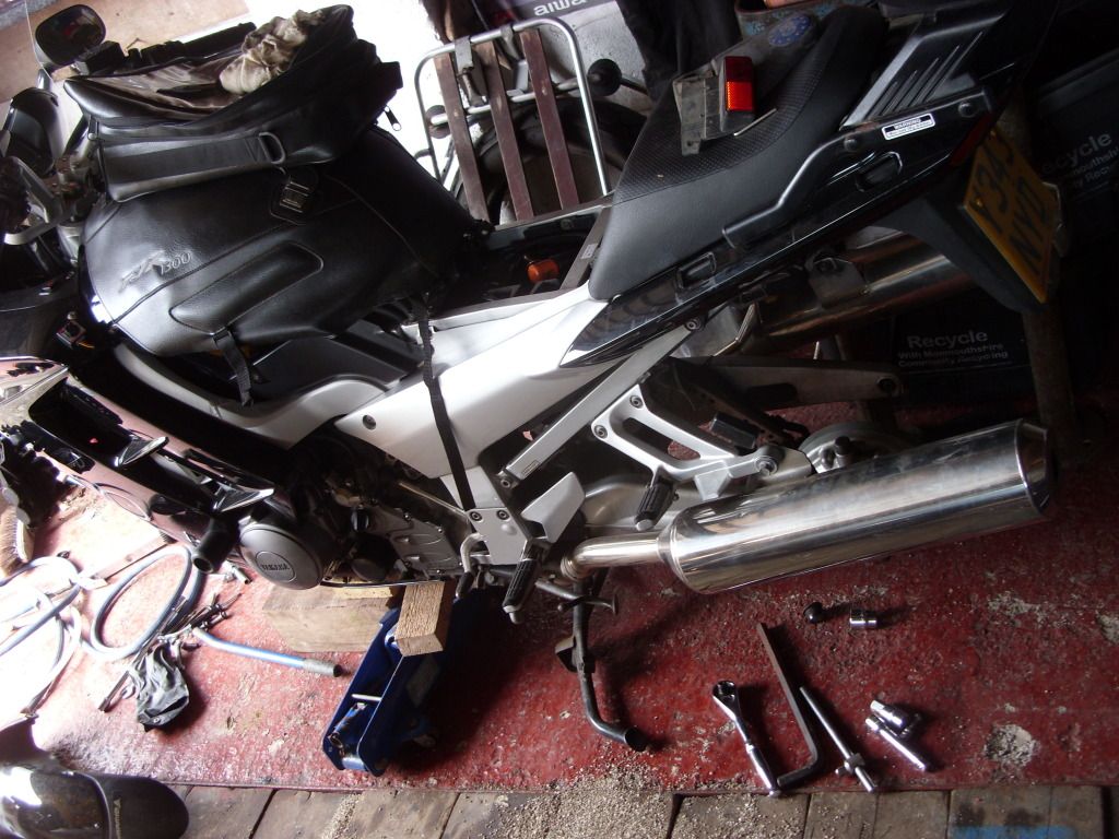

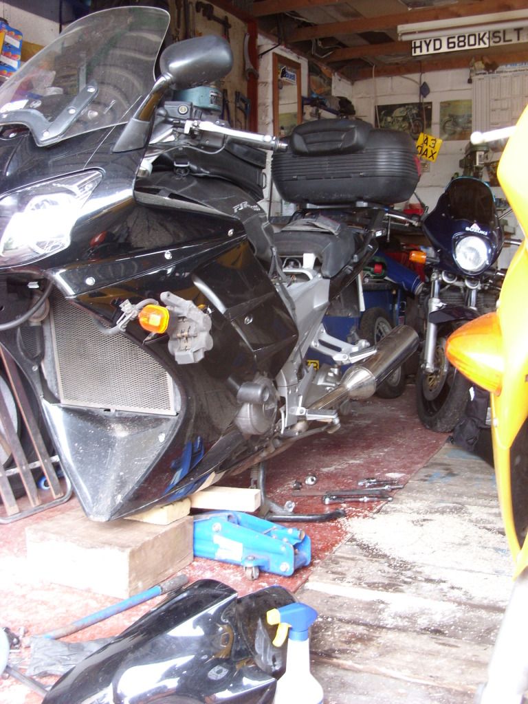

Posted: 10 May 2012 at 11:01am | IP Logged Quote toastmuncher
Well, nightshifts mean slow progress here, I have just fitted bridgestones and balanced them with my shiny new wheel balancing Jig/frame thingy, ncapability to fit AND balance my own now opens the door to MUCH cheaper rubber, wheel balancing has been something I have stuggled with for a while so .
Once wheels were out it seems the fork seals are also shot so just waiting for more 10wt oil to finish off, also suspension lift to do. Doesnt she look sad?
Im told my time would be better spent finishing the skirting boards.
